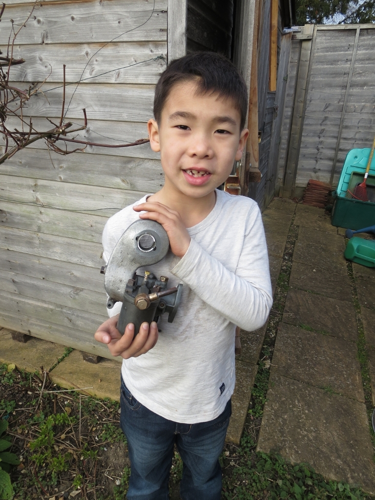

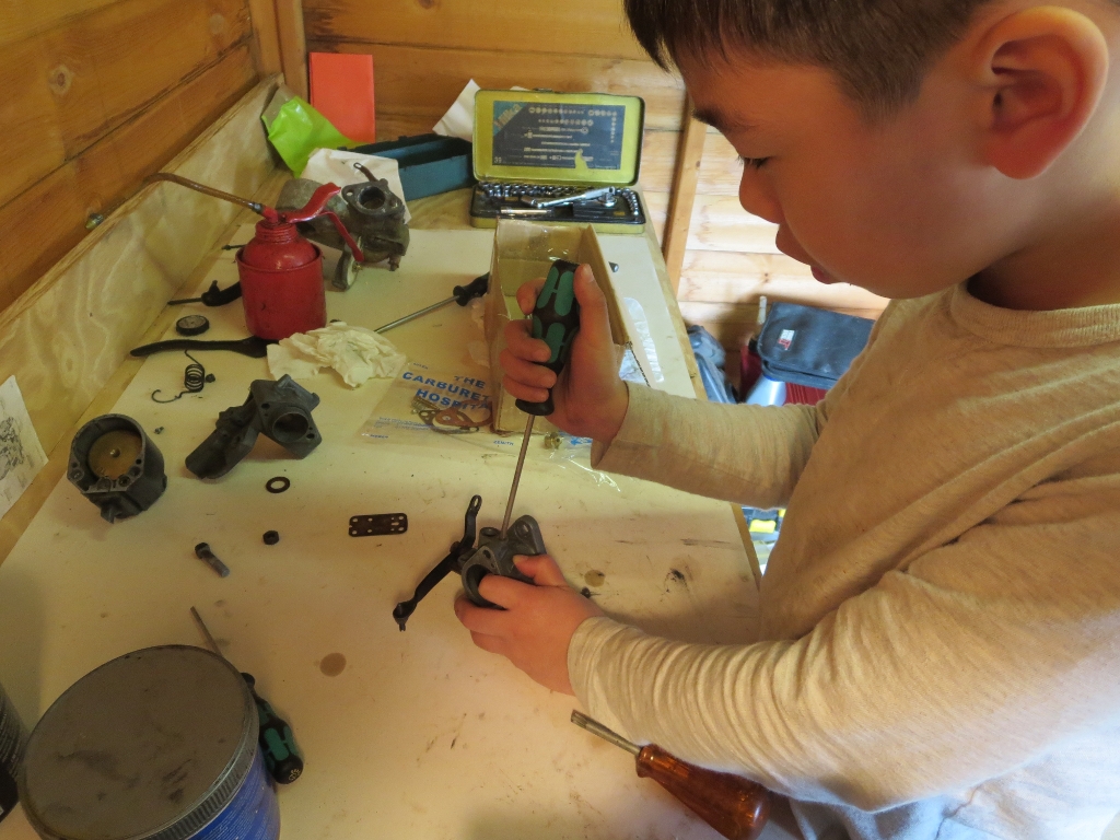

Given the wear on the spindle, it seemed pointless trying to sort the jetting without giving the carb a proper overhaul. I managed to order a rebuild kit along with spindle and bushes from the Carburettor Hospital. I also have the carb from JCS which is in quite a sorry state and has obviously spent some time out in the elements, the strangler flaps having rusted completely off. After a bit of a struggle, I did manage to liberate the jets and the body looks salvageable, so I maybe able to rebuild it as a spare at a later date.
Given the specialist job in hand, I obviously called in an expert and he now has the original carb stripped down ready for our trip to his Uncle Ian's workshop and the ultrasonic cleaner, Removing the worst of the Red Hermetite revealed the choke size is 25, which does at least seem to be correct.
I have passed on my top tip for carburettor and gearbox rebuilds, which involves using a 2 quid roll of heavy duty lining paper to provide 50 ft of clean bench. I'm not sure if it went in, but hopefully my warning about screwdrivers slipping on very tight screws, just before stabbing myself through the hand will have taught him something.

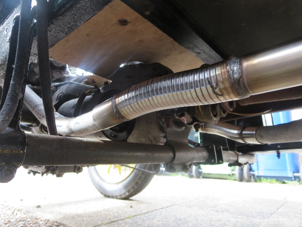

We have made some progress, despite the weather. I cut a section out of the nearside exhaust and with the aid of a friend with industrial pipe benders, tweaked the manifold pipe up to clear the cross member. A complete success, other than the off side, now being free to sit flat on the cylinder, dropped down and hit the cross member instead. Solved by cutting a section out and bending that side too, so I now have flexible both sides, which I am happy about as it does mean there's no stress at all due to the chassis flexing as the silencer, is completely isolated from the front section.

One thing I have been pondering is my rather free flowing exhaust system. The new Y piece is probably 1/2" larger diameter and the impressively large silencer, pretty much straight through. I've notice the one pre war Jowett I have seen and most other cars of the era have very narrow bore pipes. Is there any reason or theory for this? I can't think back pressure would be an issue given it's a slow revving, low performance engine?

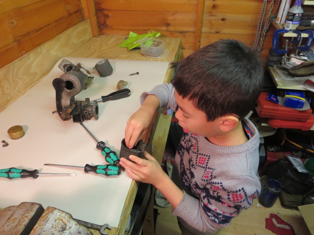

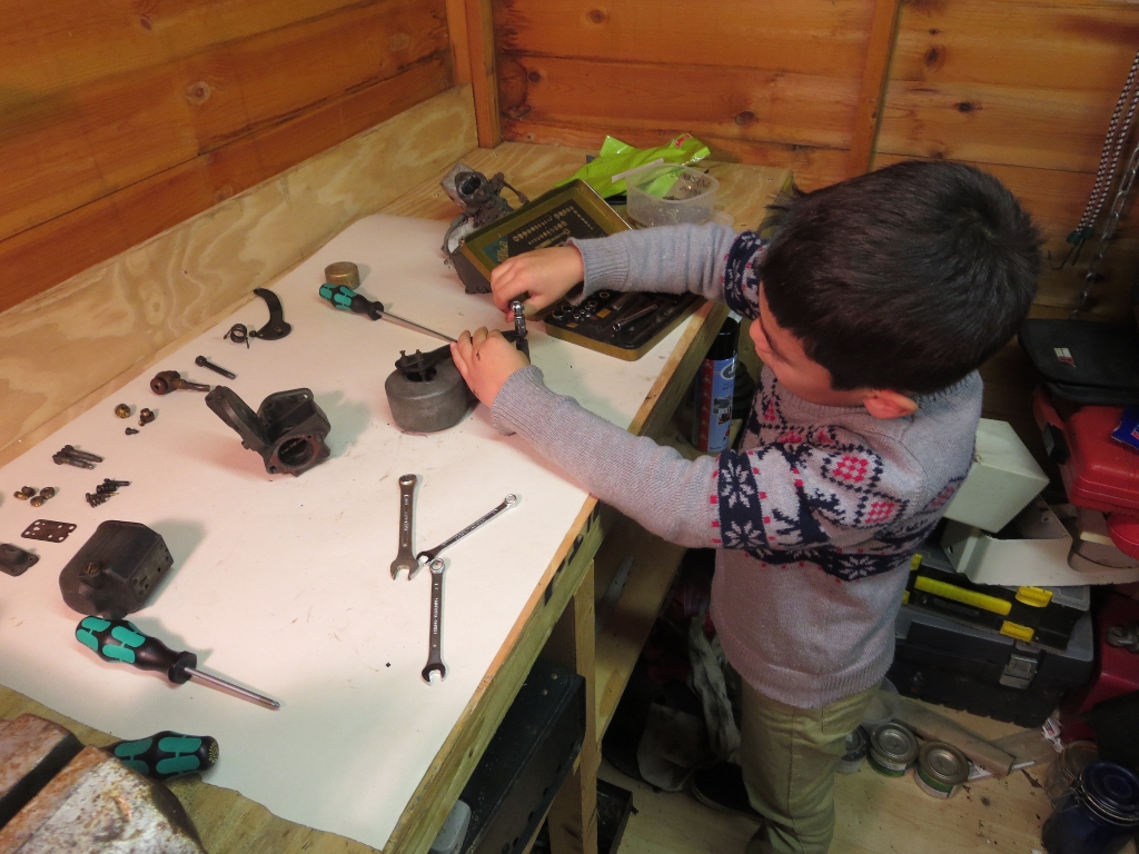

The carburettor is now hopefully restored to near new condition ready for another test run over the Bank Holiday. I've paid a fiver to take part in the local Cottenham Yesteryear Road Run end of next month, so the pressures on, even though the start line is only about 4 miles from the house, so not too ambitious.
While it's the correct model carb for the engine, I'm becoming more suspicious it could have come from something different. Once everything was cleaned and I could see the markings, I noticed the capacity tube was wrong, as well as the slow running and compensator jets. Again, the scrap carb from JCS yielded the correct size. I can understand someone changing one jet, but it seems a bit unlikely to start swapping 3 around. All the jets and capacity tube now match the sizes in the Jowett Club spec and also the spec given by Zenith I managed to find. There is a good description of how the Zentih Carb works on one of the Austin 7 sites, so at least I now understand what all the 5 jets do, which might give me a fighting chance if it's not right.
I read with interest the comments in this month's Jowetteer on getting younger people involved with the cars. Well here in Cambridge, the world famous seat of learning, we're very keen on the three Rs - reading, writing and rebuilding carburettors. Here we see the student carefully seating the tiny and delicate progression jet
And proudly showing the finished project ready for testing
