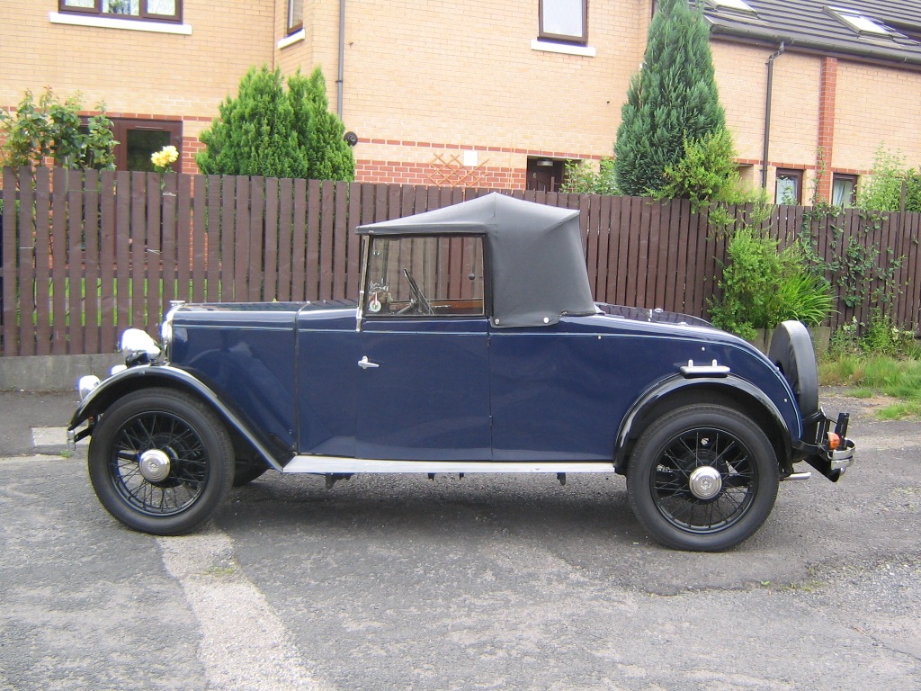

Just to whet your appetite I’ve attached a photo of one of my Jowetts, a 1933 Jowett ‘Flying Fox’ two-seater tourer with dickey seat, which I finished about three years ago after buying the chassis and engine only (no body or anything else) from a fellow Jowetteer almost 30 years ago.
