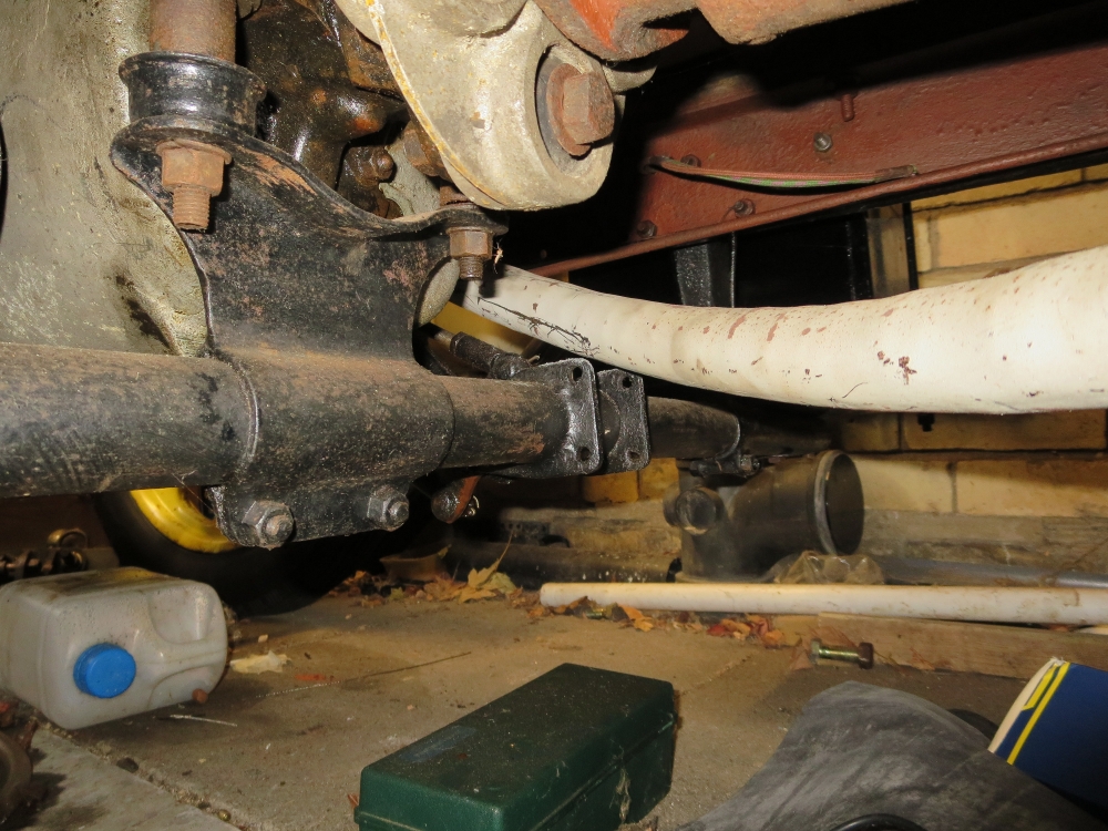

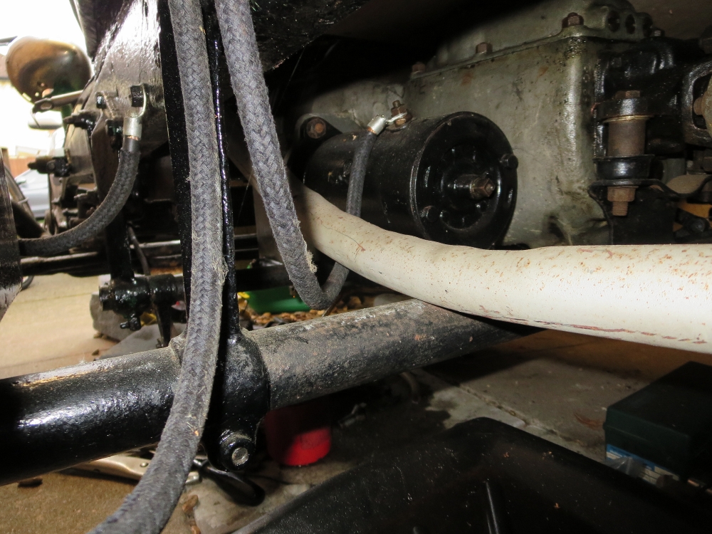

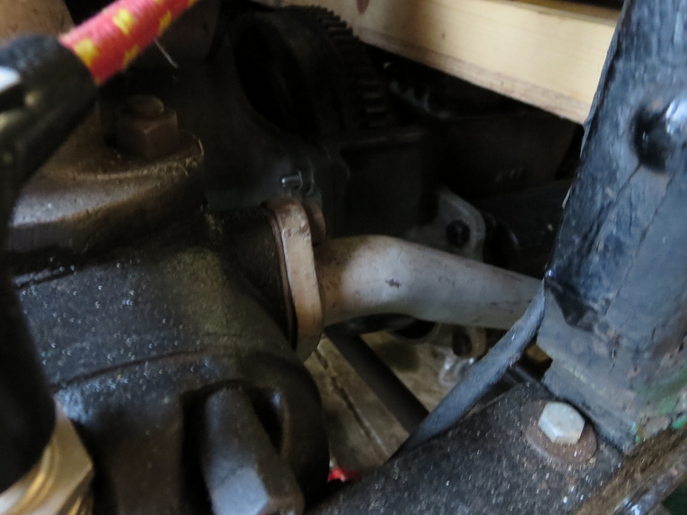

The other issue is the exhaust. As mentioned before, it is just touching the cross shaft on the nearside and my plan was to put a small kink in it using pipe benders from a friend. However, going over Julian's excellent photos, his Y pipe clearly runs underneath the cross shaft and it looks like the angle of descent from the manifold is steeper. Obviously mine is a different chassis, but given my engine sits so low, I don't see why mine goes over the cross shaft. I'm now wondering if there are more than one type of Y pipe?? When I ordered it, Ian Priestly did um and ah a bit given my engine/chassis combination, before saying he was sending something that should fit, but "might need a tweak". If there is a vintage and prewar version, would they be interchangeable between engines?

Hi Barry
When I ordered the Y-pipe from JCS, Paul did say they were 2 versions of the pipe and the lower one was the correct one for the Kestrel. Having said that the pipe does come very close to the underside of the cross bar and the hole centers on the flanges were not quite right & needed a bit of filing.
I could try & make some measurements if that would help decide if it's worth changing to the other pipe.
Julian
Julian
- Posts: 331
- Given Name: Barry
Hi Julian
i did have to enlarge the holes on this one and just touch the welds with a grinder to clear the nuts.
It would be interesting to see where it will sit if it's not too much trouble. Rather than trying to measure he pipe, I guess all I really need to know is the relative position of the engine and cross shaft. I can't remember where the old one ran, but I think it was above and it was certainly much smaller bore. It had pretty much turned to dust and had a small motorbike silencer jammed on the end.
Barry
Barry
