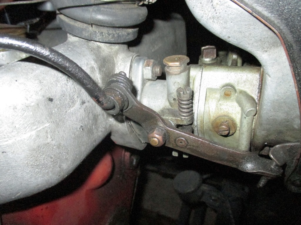

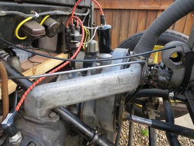

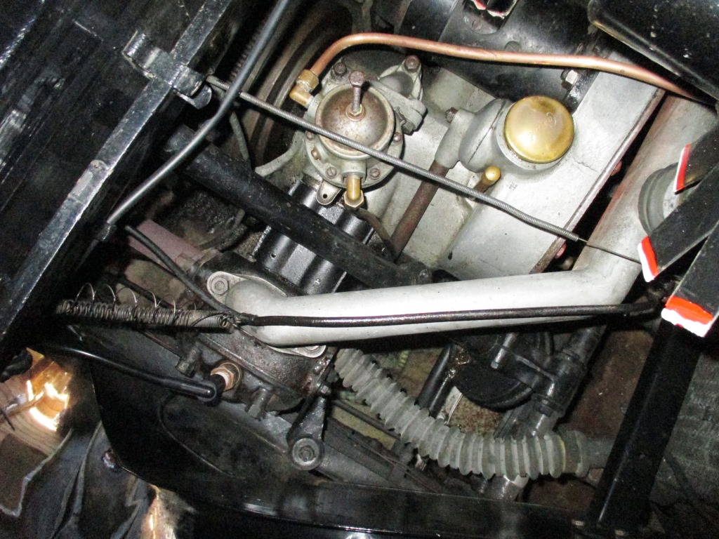

I've attached three photos as promised which might help (in a Yuri Geller way) in the bending and shaping of the throttle linkage.
I'm booked in for the National Rally at Daventry, so I'll be glad to meet up with you.
P.S. Note the engine mounting position and shape in th 3rd photo.

Thanks Tony - that's perfect!
The photos also remind me I'd like to replace the rubber fuel pipe with copper at some stage. I took the fuel pump off to overhaul it, but then realised it was probably a bit of an over complication given I have a scuttle tank above the level of the carb, so I left it off and put a blanking plate on.

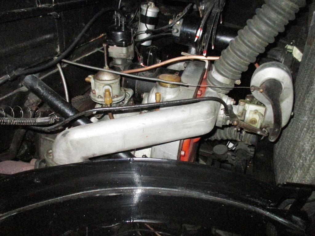

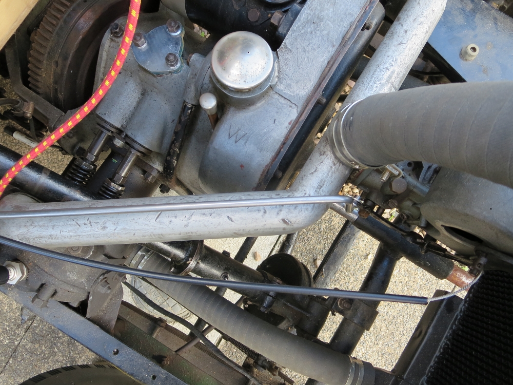

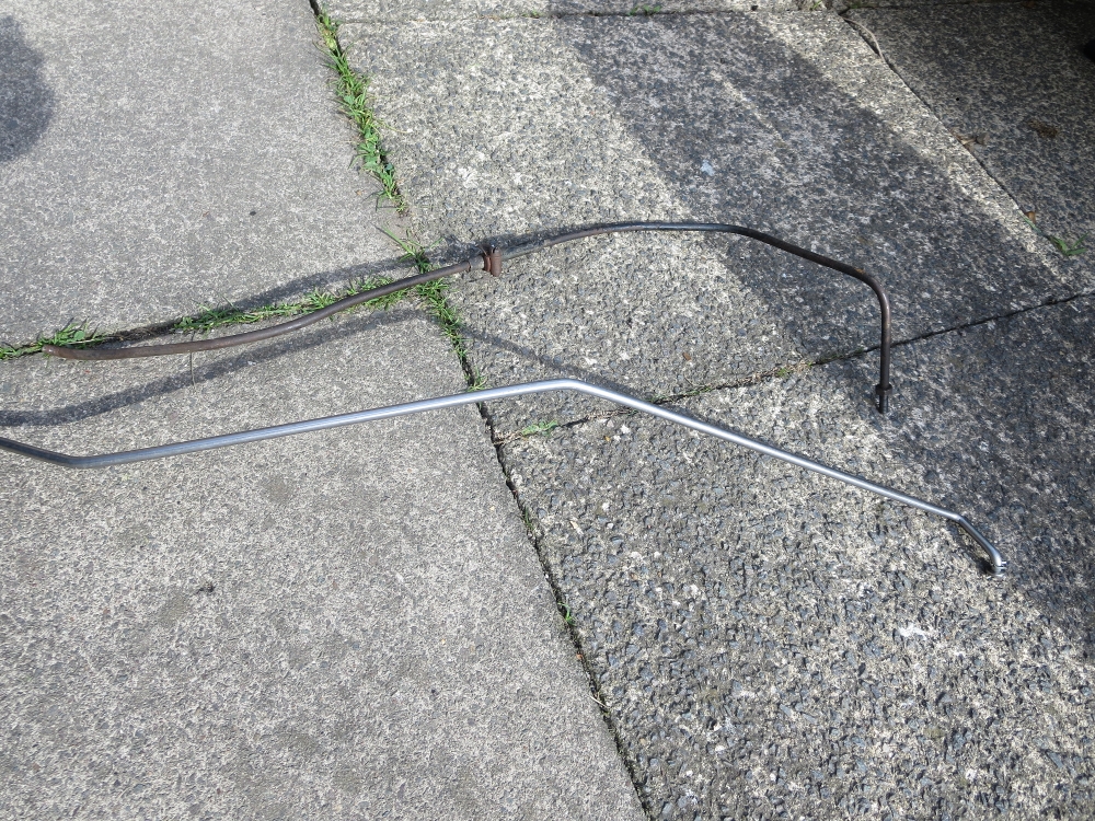

With the kids at school and he promise of sunshine, I took the day off to fashion my new throttle rod.
Sadly I fell at the last post when the box I was told had Whitworth dies in turned out to be unf, so I just need to cut the thread for the actual pedal, but still another bit of progress and the pedals are all now level.
I also managed to do a quick compression test. On a cold engine which, hasn't been run for a month, so probably has dry rings, I'm getting 50psi one side and 45 the other. Low I think, but at least similar.

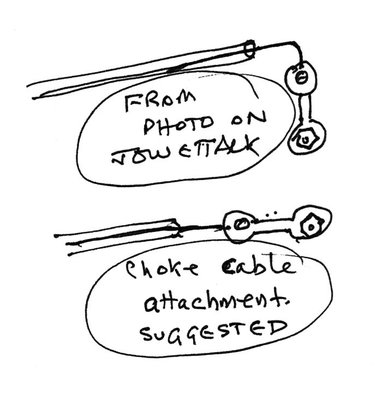

Posts: 1745
Hi Barry.
Throttle rod looks spot on.

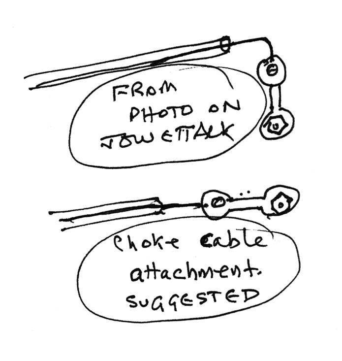

Choke cable might just need a bit of fettling to get a simple straight pull.
My suggestion below.

Thanks Tony
The choke cable's just hung temporarily at the moment, so I do need to sort it sometime. At least it's a single cable now and not 3 spliced together. Just waiting on some new corks for the fuel tap and then hopefully I'm ready for a test drive.
