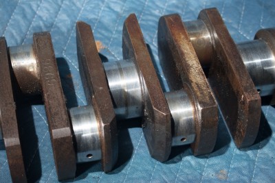

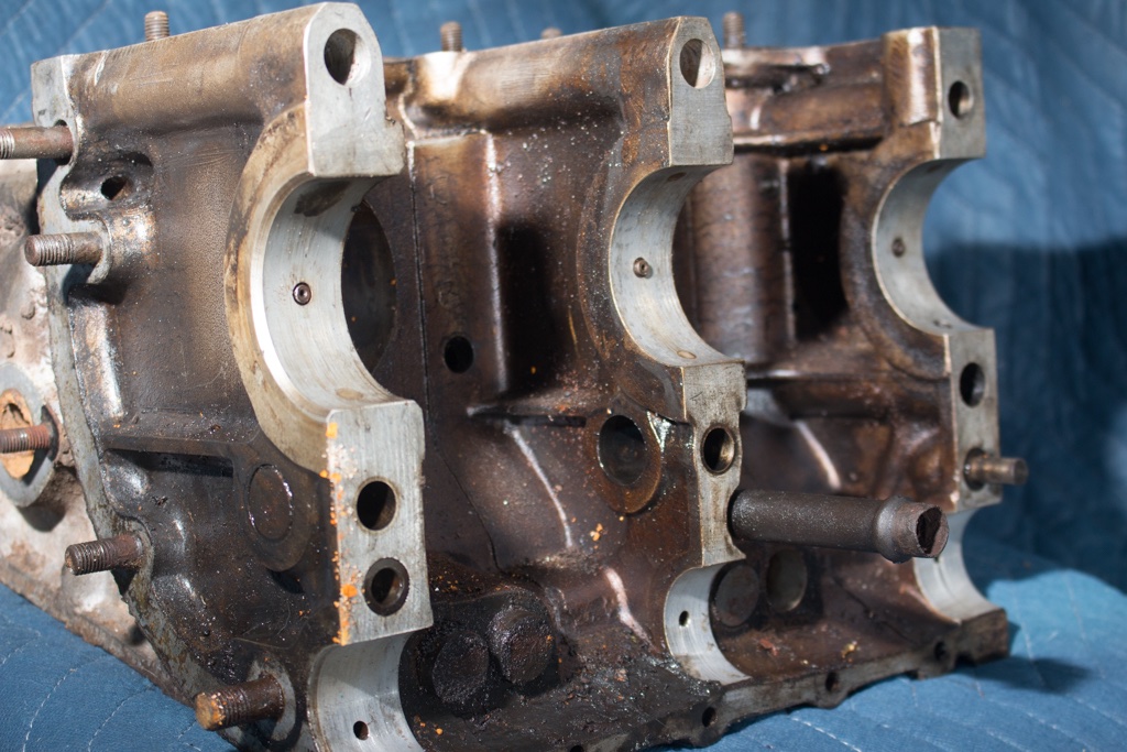

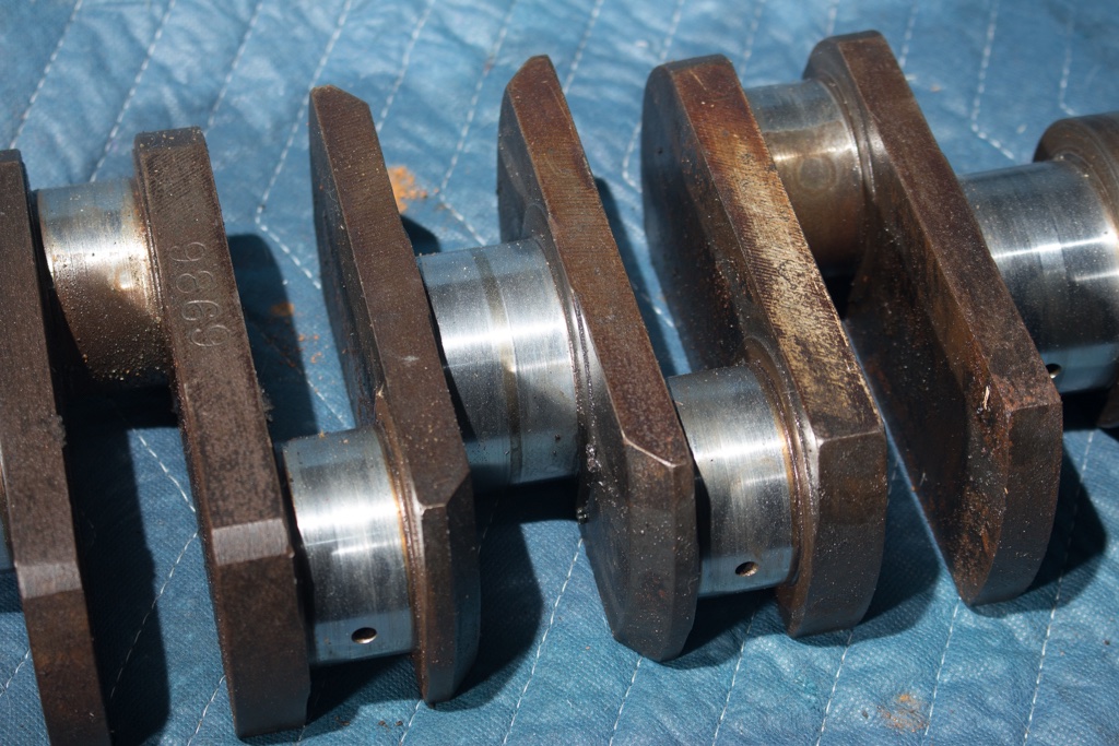

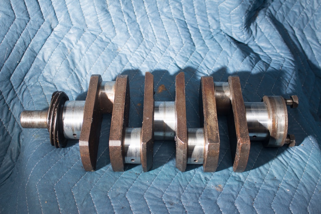

photos of the best motor I have. It is a E0PC , from the web it appears the crankcase is not that desirable as it has no oil groves for the main bearings or webbing to increase strength.
The oil pump is a short body 1 3/8th so not that desirable either.
Can anyone give an opinion on the crank,. Does the numbers on it mean anything?
From what I can work out I have nothing to jump for joy about except it is not a PA motor

Also spigot bush fell out of the end of the crank, & fly wheel was easy to remove. I thought a puller would have been needed for the flywheel.
- Posts: 547
Hey David:
Here's my POV: Upgrades are generally an improvement and a stiffer block is a good idea, but the modified modern bearings work just fine with early blocks. Also, I have driven my E0 block in my Javelin quite a bit without any signs of disaster due to the lack of the extra bracing. That block was even use for a season of racing some 20 years ago. It also hauled three of us and a bunch of gear up the mountains on a 6k mile tour. The cases are unlikely to fracture on their own; freezing and flying bits of broken rods/cranks are usually the culprits. Given the thrust is on the rear, the stiffeners add some security, but make sure your crank end play is set properly. Stiffer is better, but may not be the focal point.
All the gears in all the oil pumps are the same size; the later taller pump lowers the unit into the sump. What you want is FLOW, which means the biggest diameter pick-up and delivery tubes as the later pumps have. Also, your E0 block would need to have the oil transfer holes from the front to the top in the 1/3 case enlarged to later spec. Not hard to do at home with some drill bits.
The crank is a slightly different issue. The additional meat and rounded shape, as well as the later, better understanding of metallurgy and heat treating make the oval web a much better choice. Abuse and bad prep/assembly can kill anything though.
Flywheel is located by the small boss, not held in place, so pops of fairly easily. The bush falling out is a bad sign, as it should be a very firm press fit. Yours had to be stuck to the input shaft and spinning inside the crank. Easy to see on the outside of the old bush. You need to inspect the inside bore of the crank if you re-use it.

- Posts: 771
- Location: Sunny Bristol
Hi,
The crankshaft looks like what we call a 'black-sided'. This was the last version used in production of Javelins and Jupiters. Post production, Jowett's offered the oval web version as replacements. However, not all oval web versions are the same. There were some early versions that reputably wore quickly and yes, they can break! The later ones have the word 'Laystall' stamped on them with the word in an oval. These are the ones to look out for.
There are quite a number of used oval web cranks floating about in the UK, so it might be worth asking around? However, your 'black-sided' one will probably run for years. Without access to a lab for non-destructive crack analysis, can I suggest a simple workshop test? Suspend the crank vertically on a stout piece of wire so she is hanging free. Give her a tap with a hammer...she sound sound sweet like a bell. If the result is dull...she is probably suffering from a crack somewhere.
One or two observations about your crank...the oil way holes haven't been 'releaved' after the previous grinding. This is important. Also, the rear seal journal looks scored where the seal runs just inboard of the flywheel bolts. This wear can be taken out completely by fitting a 'Speedy Sleeve'. These are readily available in the UK and provide about 0.025" increase in diameter here, which also improves the seal effectiveness.
If you have the crank reground, make sure the workshop you use understands about providing a new radius on the ends of the journals and increasing the length of the rear journal for the new rear bearing that has the thrust bearings. JCS didn't understand this and we had to reject shafts reground from them.
Improving the Series 1&2 crankcases by increasing the size of the internal oil ways is an excellent idea. Have a work with John Airey about this, he is the wizard!

- Posts: 547
David:
I've never looked at swapping cranks as the work involved is massive. Everything has a "center" and I have always thought the easy answer is to make a billet crank rather than modify an existing one.
Here in the US, oval webs are rare and almost have to be pried from the owner's cold, dead hands. I have often thought of expediting the process with certain owners.
I would check with NZ Spares as they likely have some oval web cranks, although all would already be some undersize on the journals.
All the cranks I have done get nitrited just to be on the safe side. I know others do not do this and have had good results.

- Posts: 771
Hi Srenner,
Yes, nitriding the crank is an excellent process. I seem to recollect it penetrates around 0.025" into the steel, so it depends how deep any regrind is before you reach untreated steel. I believe all the Laystall oval web crankshafts were originally nitrided, so a 0.010" regrind might be ok, but anything deeper should have the nitriding repeated on the reground shaft.
I am sure JCS can supply s/h oval web shafts, either already reground or ready for local regrinding, if needed? Most Javelin/Jupiter owners in the UK have one or two stashed away, just in case.
