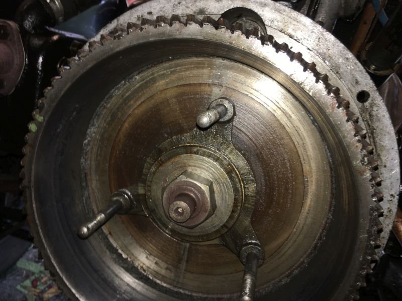

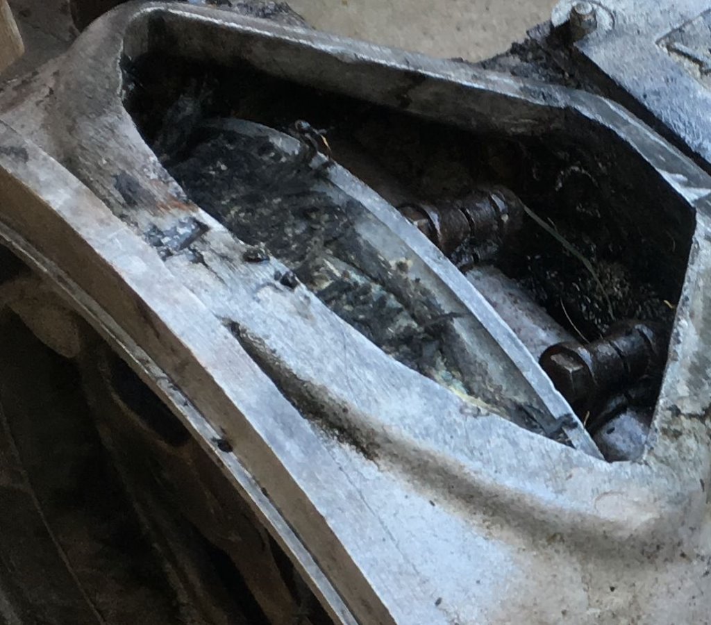

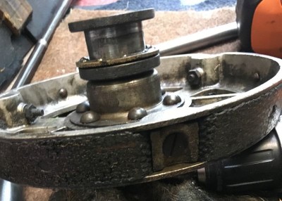

Pictures of the clutch's. The converted cone has been machined to half its original depth, which seems a bit unnecessary. It would not interfere with the operation of the clutch if it had been left.
you can just see the knot of asbestos which had freyed and bunched up
