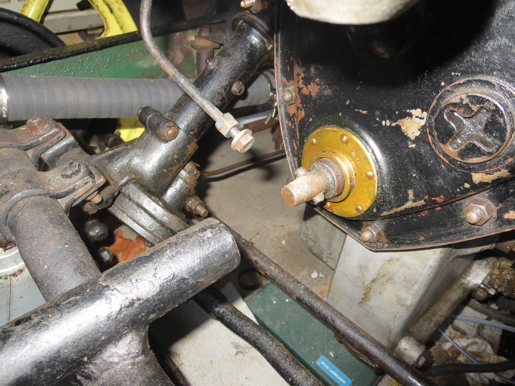

Hi James
The engine has a boss and peg arrangement as shown. The measurement from the crankcase cover to front of the crank tube on the cross member is 10", the tube having an inside diameter of 1"
Given the engine seems to sit a lot lower than the original, I wonder if the cross member is off the 1934 car that donated the engine and box, as the tube does line up with the crank boss.
Thanks, Barry

Post by James Baxter »
I think you need a piece of tube 1 inch OD. I would get some CDS tube.
File a dog in the end and clamp a standard prewar handle on the end. I will look for my spare handle.
I agree your front member looks later.
All this assuming you are happy to keep the engine installed? I have a 1929 engine available if its of any use?
