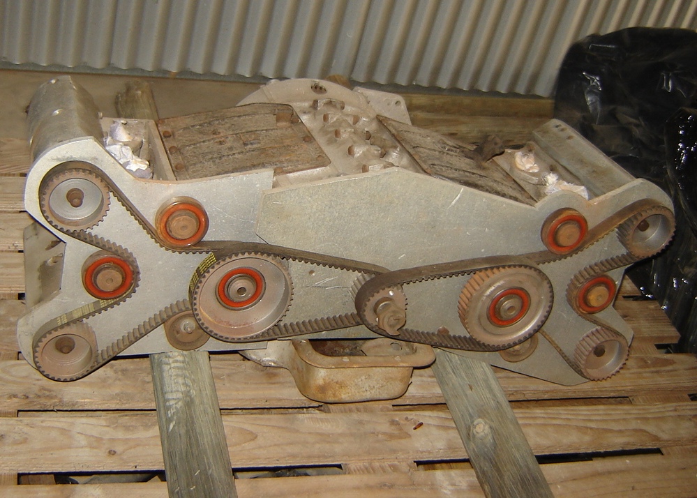

I saw a pair of aluminium (double overhead cam) heads fitted on a Jav/Jup engine earlier this year! They are owned by ex-JCCA member Joe Caudo in South Australia, but unfortunately, the engine is not yet running. It is still in the development stage with several "issues" to be resolved before it can be run. I believe that Joe has owned the heads for about 15 years. They were designed & manufactured by S.O. Hodge, who also built replica standard bodies for 5 Jupiters in Sydney NSW.

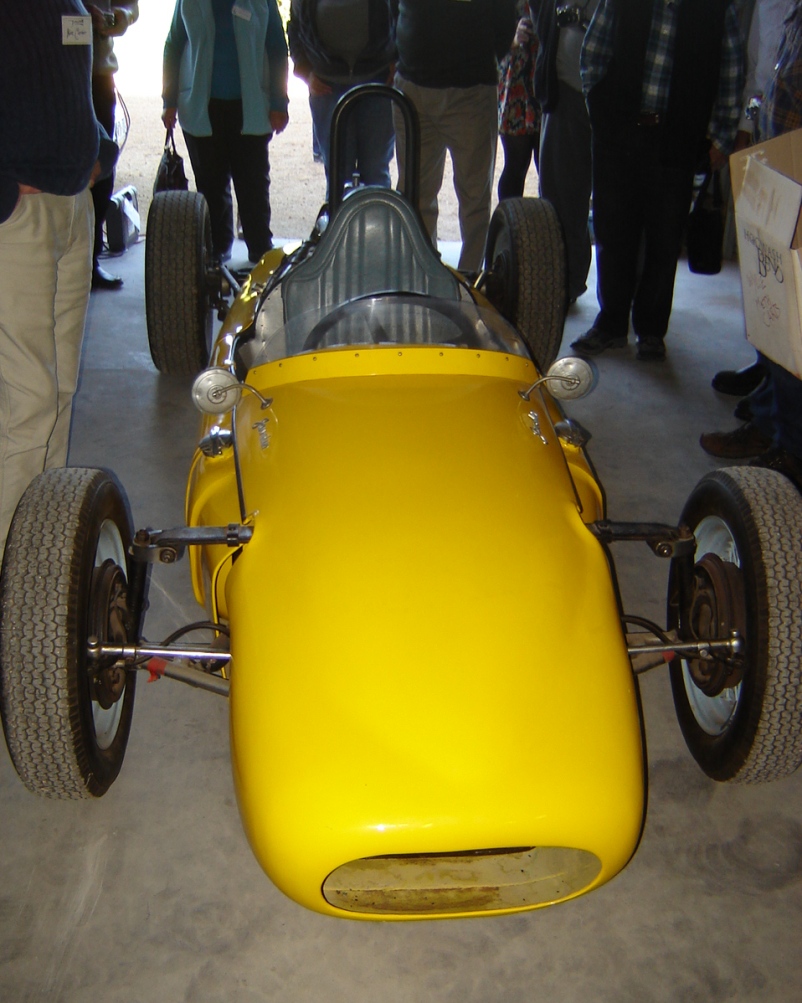

Joe also owns the famous Wylie Javelin open-wheeler GP car built in 1952 that runs a supercharged Javelin engine.

Hi Andrew,Andrew Henshall wrote:I saw a pair of aluminium (double overhead cam) heads fitted on a Jav/Jup engine earlier this year! They are owned by ex-JCCA member Joe Caudo in South Australia, but unfortunately, the engine is not yet running. It is still in the development stage with several "issues" to be resolved before it can be run. I believe that Joe has owned the heads for about 15 years. They were designed & manufactured by S.O. Hodge, who also built replica standard bodies for 5 Jupiters in Sydney NSW.Best wishes to all for the New Year,

I was thinking about a very similar casting to the steel one, but that is something else. Wow. Can we get some more details on the heads and engine build? That looks, well, utterly bonkers, and as a result very interesting

do they reduce the turning circle to around 100ft!

I don't have any more technical info about the DOHC heads, and knowing how busy Joe is, I suggest we shouldn't hold our breaths waiting for more to become available! I'm writing the history of the Wylie Javelin for publication by the JCCA, and await additional info from Joe on his historic open-wheeler; I have to be patient as he has a couple of large businesses to run. I did hear that he was going to take the Wylie Javelin to Mallala Raceway SA for a test session late in 2013 and was thinking of attending, but couldn't find out when it was.
I understand that Joe purchased the DOHC heads from Tim Hocking of Brisbane, but don't know how Tim came to own them.
George,
The quad-cam engine is no wider than a standard Javelin engine, and should fit into a Jupiter without causing any significant restriction in steering lock. Don't know about a Javelin though. If Joe is able to resolve the remaining issues and get the engine running, no doubt it will be fitted to his Targa Tasmania Jupiter to be fully sorted.
