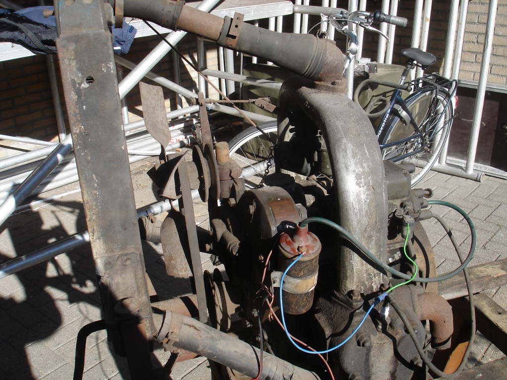

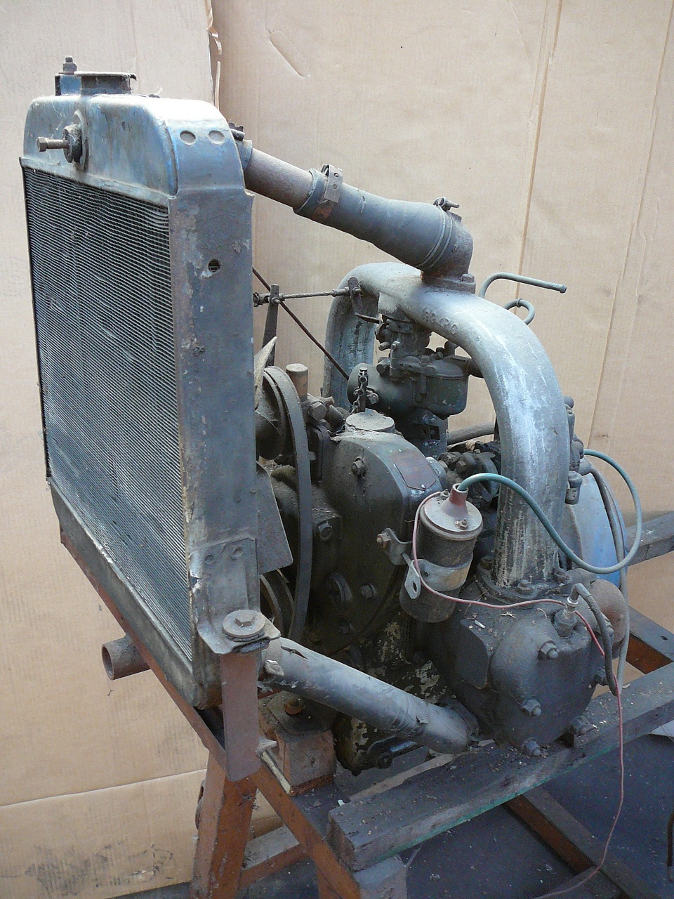

I have an engine from Jowett a 2 cylinder engine number 454495 but I dont know were it was from
Greetings Rene Vosters
info'at'vostersvof.nl
Can you help me find out which car it was?
Which car had this engine?

This is probaly ( I am not absolutely certain!) a JOwett engine from a Bristol tractor, The radiator is very like that use on the tractor and other identifying features that I think apply only to the tractor rather than the wartime industrial engines is the pulley on the front of the crankshaft for a fan belt. It also appears to be fitted with a magneto ( presumably only being used as a distributor because of the separate coil shown in the phot) Bristol tractors used a magneto. I would put its date at 1940 to 1942 as it has 4 nuts holding each end of induction pipe to cylinder which I think came in in 1940 and Bristols stooped using the Jowett engine sometime in 1942 changing over to austin power units.
The above is a 'best guess' as I am not an expert on either Bristol tractors or Jowett industrial engines.

Re: Which car had this engine?
the number 454495 looks correct for an industrial engine of c1942 as eng numbers 454482 and'89 are in the 2008 club register of industrial engines.
